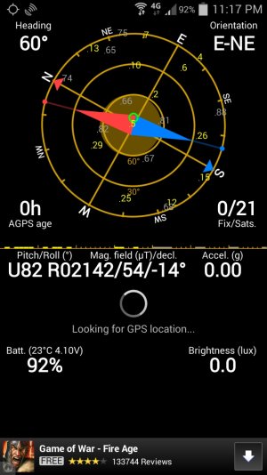

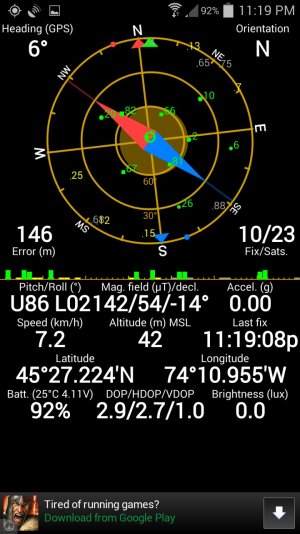

I have used that app. If the GPS receiver works in that app, then it works in maps...so if you say it's working in that app, you can see the satellites? It will absolutely indicate GPS, if it sees satellites. If you can, then the unit isn't defective and the problem you have would only amount to it being a software issue with Google maps. That's an easier fix.
This shot has no GPS data...but look at the short yellow bars below the compass, on the line. Each bar is a satellite in the process of being acquired.
This shot has GPS data...and now look at the short green bars below the compass, on the line. Each bar is a satellite in that has been acquired. You see a total of 10 satellites of out a possible 21. You see a latitude and a longitude as well, which is my exact GPS position at the time of the screenshot
