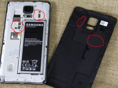

There are 9 metal spring pins in the phone that connect it to the back cover. I took a small screwdriver and gently slid it under each of the pins in turn, deflecting each of them slightly upward. They are delicate, so be really careful. My LG Optimus G Pro suffered a similar problem with the LTE radio, and has spring pins almost identical to these, and one broke when I went to add a little tension to them. I was much, much more gentle this time.
It is my (possibly vain) hope that this is a simple hardware connection problem. Though, to be honest, the back cover doesn't actually show any connection points, so it has to be inductive through whatever paint or coating is on the inside of the back cover. That seems somewhat less than ideal for antenna connections, but I don't know a whole lot about radios and antennas.
(attached picture is not of my phone, I took it from Ubergizmo)

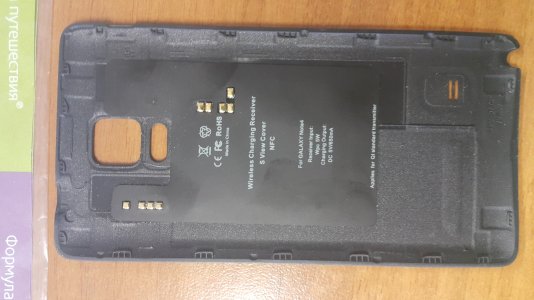

These are contacts for wireless charging Qi Receiver.
This is a third party cover I have. It doesn't seem to affect GPS performance as it was stellar at first with it and without it, then it became horrible and after factory reset it works better but still very unsatisfactory.

Huh, so none of the contacts I just bent upward have anything to do with the antennas? Bummer. Well, at least I didn't damage anything. Guess I'll find out on the ride home if I did any good, but it looks like I did not based on the picture of your wireless back cover.
