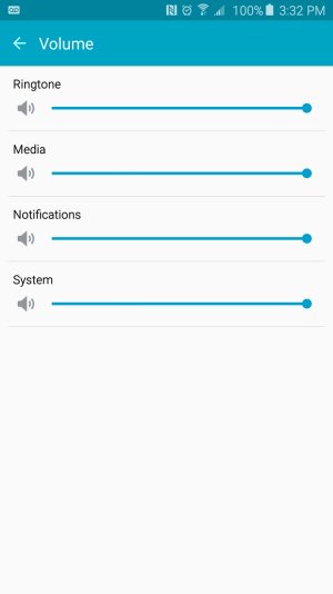

Samsung Galaxy Note 5 Text Message Notification sound not working.
Is the notification volume turned up?
Are you running the stock message app?
Posted via Note 5 AT&T
Yes...notification volume is at max.

And did you double check to see you have a music notification selected?
ok....I found the problem. it was the notification within the app. I have no idea how that got turned off.
Thanks a bunch!!!
