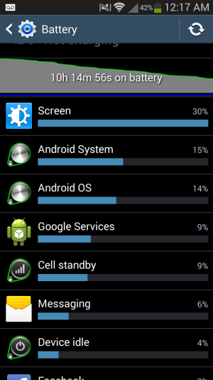

Thank you for the information! I really hope its just the whole reception issue. I attached two more pictures with the the screen info. Hope that helps.

That's pretty good actually - 42% battery remaining after almost 11 hours, with just over 2 hours of screen on time. Other than your horrendous cellular signal quality I don't see anything wrong with your battery life.
(Remember to always include all three screenshots; always start with a full charge; never perform any intermediate charge cycles; let the battery get depleted to less than 30% if possible.)
