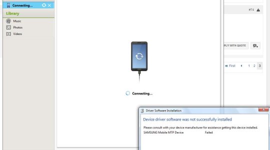

My phone is not recognised. It says please connect a device. (MTP driver has failed too) But it did accept the model no etc.
I'd be really grateful if someone could advise on what to do next...

Ah ok, thank you. Will installing the MTP driver make any difference? If I can find it anywhere. My model number is GT-I9300
Re: Samsung galaxy S3 frozen on start screen... HELP PLEASE!
I don't know what 'MTP' driver you're referring to - all I ever did was install Kies, it installed a bunch of drivers, and everything has worked.
When you're running Kies (without the phone connected) and then connect the phone and turn it on, what happens when the swirly screen on the phone comes up? Does Kies recognize the phone as in the screenshot I provided in post #68? Or does it just show 'Connecting'?
