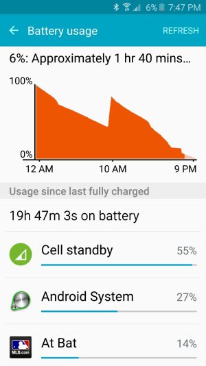

I'm on T-Mobile and went from 100% to 60% overnight. Recharged to 90% and couldn't make it through an 8 hour shift with little or not use.
55% for Cell Standby!!!
Just got by from T-Mobile and they don't have a clue. Any answers out there?

I'm on T-Mobile and went from 100% to 60% overnight. Recharged to 9 I 0% and couldn't make it through an 8 hour shift with th little or not use.
Try my suggestions on this link first, if still the same just get a replacement and in the next one just be sure to do what I suggest about the update and wiping cache and data first and then your choices of the rest.
http://forums.androidcentral.com/samsung-galaxy-s6/514137-adjustments-tips-tricks-maximize-battery-life-samsung-galaxy-s6-edge.html
