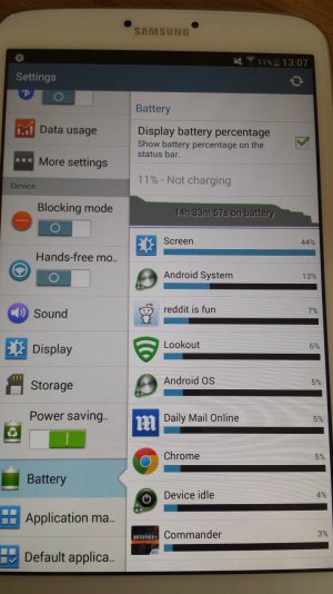

Hey all,
I have had my Samsung Galaxy Tab 3.0 8 Inch since May 2014 and everything has been swimmingly until yesterday, when my 100% battery dropped to 17% to 7% right before my eyes, and then after a little research, 47% down to 6%, rebooted and it went back to 44%, but the battery dropped instantly to 20% or so.
I have Wifi on all the time, location/GPS off all the time, max power saving options on (limited processor and brightness) Half brightness (tried lowest & auto, but to no avail).
The device is not rooted, it is legitimate.
Bluetooth is always off as well
Solutions I tried
  • Clearing the cache
  • Using either charger from my phone and tablet
  • Scanned for malware etc...
  • Uninstalled several unconsuming applications, uninstalled facebook + messanger
  • Used Super Task Killer Free + Quick Settings
  • Unmounted and remove 16GB SD Card & restarted
The settings -> Battery show my screen constantly at 45-50% even at idle/use and refuses to go down, leading me to think this is the problem but I have no idea how to lower this.
Any other solutions? If my 0% to charge tactic solution I seen doesn't work I will end up contacting support/taking it to a shop to get it fixed.
Picture:
Thanks.

The screen is at 44% battery usage still in the settings -> Battery
EDIT: Now on 9% by doing nothing

Give it a full charge and see what happens. Allow it to drop to about 35% (normal use) and post the screenshots of the battery stats.

However, I can view my battery going down 1% by 1% still so it still is worrying, any more solutions or is it the best i can get? the screen still takes 42%

The screen is almost always going to be the biggest battery draw. Especially if the game, like you mentioned, relies heavily on the CPU, and screen.
I would just wait and see how this charge comes out.
