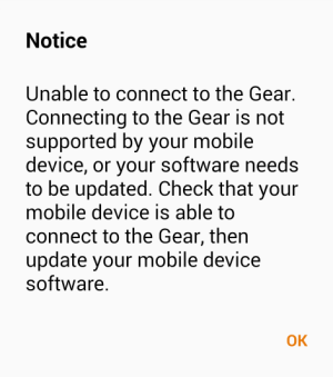

annnnnnd now there is THIS coming up...
This has been working since the Gear S came out... WTF??
I had some kind of error message when I tried to upgrade when not connected to wifi. I suspect the speed just wasn't enough to get the download through. Just thought I would toss that out in case it may have something to do with your issue. On wifi it worked.

I had the exact same error message when I bought a second Gear, a Gear 1, and tried to connect it to my Note.

Last night, I tried to open up the Gear Manager and was prompted that it needed to do updates.
After both updates the Gear Manager is back to working properly. :)
