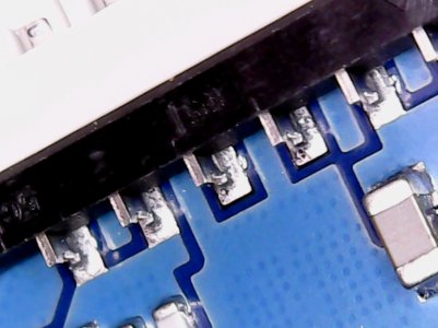

This is where you should look for flickering problem. If it's moving when pushing the connector or the pins misaligned with solders joints, then you have a cracked battery connector.
The fix is simple: reheat to melt the solder and add more to secure these pins to motherboard.

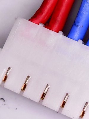

Some will still see the flickering screen after re solder the battery connector, a little more work to fix it. This time it comes from the connector attached to battery's cable.

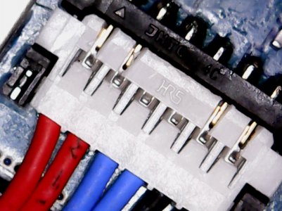

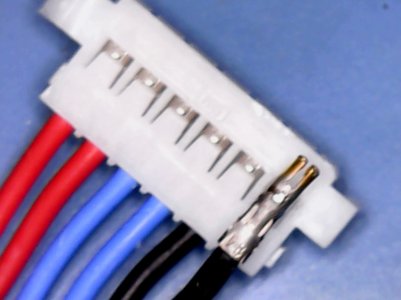

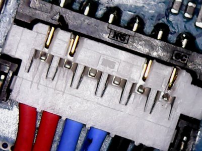

This is the top view of this connector:
This one, one cable is pulled out to see how it makes contact with pin of the connector soldered to mother board
This case, all pins make good contact:

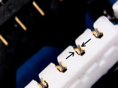

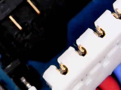

This case, two pins on the left side don't make good contact, they sit in the middle of the opening of battery cable's terminals.
How to fix: push the opening closer so these cables can make good contact with pins of battery connector.
How to do it with a thin knife; the closer the better contact . Many good working batteries are wasted, because most users don't know this trick

Reheat will not work permanently as gradually it will Crack again. I see some new main boards have cracked battery connector just after few months. You should add as much solders as possible, the main board sits on top a flexible LCD and only secured with 3 screws . That's the reason this problem is most seen in 10 inches or larger Samsung tablets.
Solders should be added like this, the more the better of prevent it from cracking
And original battery connector with weak solder joints
