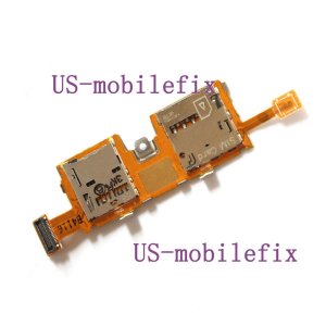

For the SIM card slot, it's not expensive and easy to replace. All you need is remove the back cover, then take out 1 screw to take out the SIM and SD flex cable.
New Sim Card Slot Holder Flex Cable Board for Samsung Galaxy Note Pro 12 2 P905 | eBay

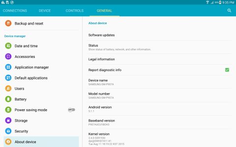

If you want to update to Lollipop, download these 2 files and use your SD card to update
http://forums.androidcentral.com/sa...roblems-np12-2-blue-screen-2.html#post4963702
Remember to back up your files as after update, it automatically reset your tablet
