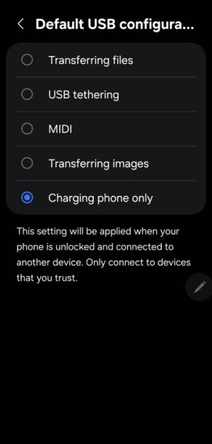

Tried safe mode, Developer mode, Samsung device care. Looking for a non-root app now that would let me switch from "Charge" to "File Transfer" without having to go into Developer mode.
I don't believe there's any apps out there besides the developer setting

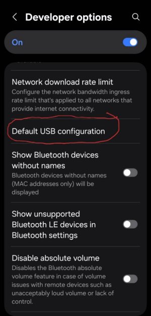

Sometimes if that option doesn't show up you have to go through developer settings if you tried different cables.
i haven't done the multi tap procedure to get into developer for several years now!! :cool: where in developer do you toggle data/charge option??:cool:
