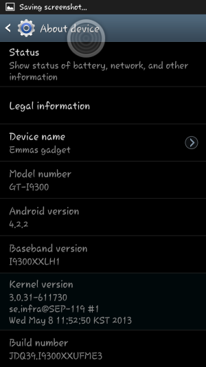

hello all, after loading 4.2.2 my multi windows worked for like 1 week but recently my multi window tab is greyed out and refuses to be enabled.... kindly assist resolve
hello Ichi_Bear...... Screenshot_2013-09-25-09-11-17.png see screen grab of my phones about (HOT MOBILE) , i think all the info you need to assist me is in there.....
thanks
That doesn't look like an official update. Did you flash the leaked ROM? I haven't flashed this new ROM for just this reason. Still a bit glitchy. I'm gonna wait for the official release before I update. If you don't mind these little glitches, then I say carry on regardless. If not, do a full factory reset and do a fresh update.

yes I did flash the rom.... I have just followed ur instruction of doing a hard reset, all though I back up all download app and data using titanium backup pro...... before the factory reset and every thing is okay now...... many thanks
