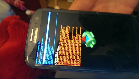

Hi guys!
So Im gonna shortly explain whats happening to my phone, and you all can take your conclusions about what the problem could be.
My s3 was working fine until a few hours ago, when me friend called me. When he hung up, my phone was frozen already. No response at all... I held the power button to perform a 'reset', but it is frozen now on the first splash screen. Tried removing battery, everything.
After a few searches and few topics (http://forums.androidcentral.com/sa...alaxy-s3-frozen-start-screen-help-please.html), got a conclusion that I am another victim of the SUDDEN DEATH SYNDROME that have been affecting many users on UK.
However... I dont think I really qualify into this category, since I can turn my phone on, and get into the Recovery mode.
Now thats the funny part. My recovery mode seems very messed up.
There are many lines of code saying
'E: failed to mount/
E: cant mount/
E:Cant open'
etc etc
Someone give me some instructions on what to do please! :confused:
Cheers
If I'm right, it's caused by a failed flash module.
If so, your phone is now a brick and you can't recover it.

Well it won't hurt anything to try again, but it doesn't sound promising. I've done this several times to my phone just to get the process down and have never encountered an error. Of course, your phone was having problems reading from memory so something may be messed up.
You could try using Odin to load a ROM (stock; rooted; or a 3rd party ROM) but that's a bit more involved, and you HAVE TO BE SURE you select the correct file for your model/carrier. I don't want to try that route since it can lead to a totally unusable device.
So I'd suggest just contacting your carrier or Samsung to see if you can get a warranty replacement (if I'm not mistaken the warranty on the International version is two years). Sorry.

Just updating you guys:
-I brought my phone into Vodafone yesterday. The guy tried to fix my phone by using ODIN, but it didnt work for some reason, and he doesnt know what could be the reasons for that. Unfortunately i cant send it to Samsung because i have a cracked screen. =/ he believes that something very nasty happened to the flash.
-My phone is at the moment in some repair shop, where the guy guaranteed me that he can fix it by Tuesday.
Lets just wait now and see what happens.
