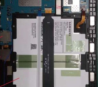

So I was using my Samsung Tab A 10.1 and I dropped on my carpet. All of a sudden it just blacked out and I tried turning it on and. When I turned it on it was in some sort of trance where it was all drifty. I shut it off again and it wouldn't turn back on. Please help

There are different between a not turning on and turning on but no display.
No display, your tablet will have some sound in the background when starting up or the back and menu will light up when press the HOME button.
In this case, the LCD cable probably get loose as it's a plugin to connector on mainboard. You just need to pop it up and plug it in again.
In this video, the LCD cable ( orange ) is on the left side of the battery. Don't use the metal tool as this guy as most inexperienced users will damage the LCD frame and the tablet should be OFF when doing disassembly.

If you have a HDMI adapter, connect your tablet to a TV via HDMI cable, it will show the display if your tablet is ON ( have sound but no display ).

This is a common problem of SM-T580, the connector very weaky secures the lcd cable. Just reseat the lcd cable and secure it with tape to prevent loose connection.
Test by plug in your charger, you should see the battery icon if you did correctly

Unfortunately all of the disassembly vids are for tabs other than the sm-t580/585 (the 580 apparently has a lot of 585 parts inside...and more screws than my laptop!)
You don't touch any screw, just remove the back cover, then reseat the LCD cable. Actually Samsung tablets are very simple with few screws.

The LCD cable is the black one, located along the center of the battery.To avoid a short, battery cable should be disconnected first.
You just need to lift up the locking tab at the top of LCD connector, be careful as it's very fragile, then push the cable all the way in , press down the locking tab and secure it with tape. A simple fix for many Samsung tablets which suddenly have a black screen but having sounds in the back ground.
Without tapes, this LCD cable can get loose easily, even without a drop.
