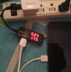

I have looked all over the internet to see how to resolve this problem. I have tried about all techniques listed out there. Tested the Samsung Charger with USB voltage tester and it was reading just below 5 volts.
If you're using 5.3 Volt charger, it should read around 5.2--> 5.3 V, current should be around 1.7Amperes
Even 5 Volt charger, you should have at least 5 volts, anything under 5 Volts, something is wrong with your charger.
Try another charger, USB cable one by one to see anything is different.
If using known working USB cable and charger makes no different, you should try to change USB flex charging port, around $5 to $10,
