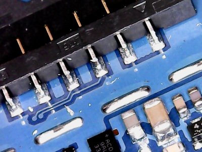

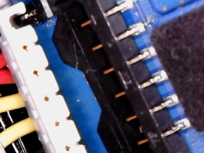

Look at this connector and do you see anything wrong ?
This connector actually has hairline cracks, push it gently it'll move
