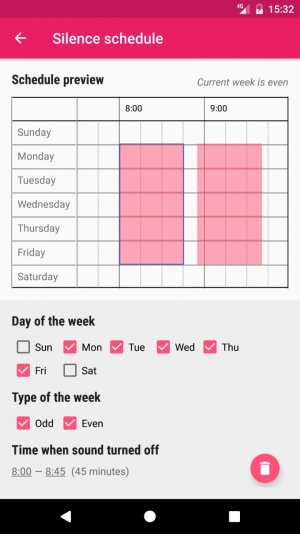

I've got Do not disturb app to work, follow the instructions in the apps help section. I like having a vibrate only mode at work. I've set tasker to use 'audio/silent mode/vibrate' based on a calendar entry for when I'm at work. I leave the alert slider set to normal. DND app then sets silent on schedule or calendar key words like 'meeting'.
I couldn't get tasker to set DND properly and have it turn off vibrate at the same time.
DND app doesn't work now properly after 3.2.1 update. I've tried tasker and DND to automate control. The phone will go into priority mode without issues but doesn't come back out of it. The only current way to do it is when DND is cancelled, cycle the alert slider to another position then back to normal (bottom) position. This returns the full audio controls until the next DND session is used.
Everything seems fixed in OS 3.2.2. I can set the alert slider to any position and then run a tasker task to set vibrate only, all audio or silent mode. The slider can be used to override the tasker setting but tasker can be run again to re establish the desired sound profile.
