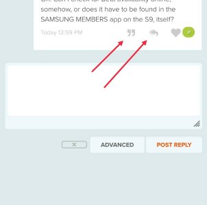

Those 2 arrows in my screenshot first is to reply with a quote to that person 2nd is to reply to thread without quote. Sorry couldn't load in PMScreenshot_20191115-132546__01__01.jpeg
