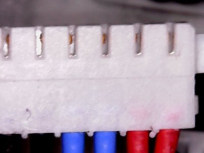

Majority problem is from the black battery connector on main board. This one needs to re solder.

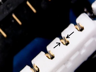

Minority is from white battery connector which has battery wires loosely contact with pins of black battery connector, pushing the clips of battery wires closer will fix the problem ( read the above link to see why I do this ), no need to replace new battery. I had one flickered at 70% battery, even after re solder. After a quick fix, it works fine, no flickering even at 20% battery.

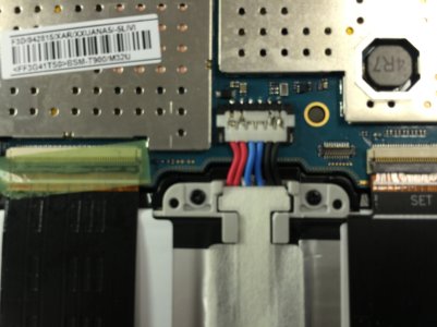

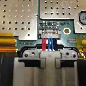

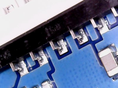

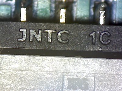

This is the original with minimum solders and had hair line cracks, I could move it easily by lift or push.
Be aware that the connector may look fine from the top but there are tiny cracks under it. I always test by slightly push the connector as some may look normal, even under 10x magnification like this one.
This is a re soldered battery connector with a lot more solders added to prevent cracks or loose connections.

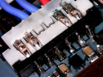

Be aware that they will solder directly the battery cable to battery connector, you'll have problem of disconnect the battery in case it's dead. This is what I see they did for a tablet returned for repair. An average user has no way to remove the battery as it's soldered directly to the battery connector.
The guy at repair center did just haft of the fix: soldered battery cables directly to the connector but did not re solder the battery connector, the tablet will flicker when battery is low. I know this is a work from Samsung repair center because an average user has no knowledge which cables should be soldered to the connector.

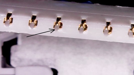

You only need someone to re solder the black male battery connector to mainboard.
The white female connector also need to be fixed, look for previous post how I adjust the tip of battery cables,
