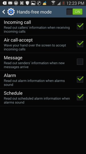

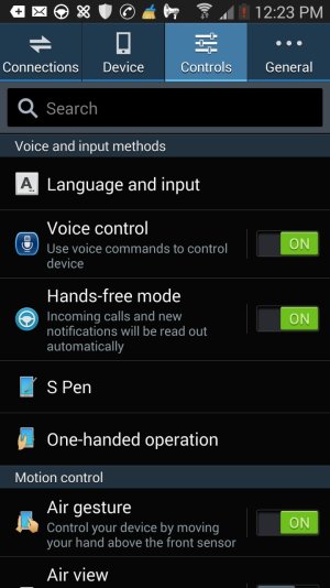

Turn on Hands Free Mode. Settings (the gear) --> Controls
Look for a steering wheel and turn it on.
Go into that Hands free menu and turn off/on the settings appropriate to you.
Drawback: You must lock your screen manually while on calls.
I assume you have hands free mode...
