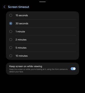

I have my screen set to timeout after 1 minute. I can't pinpoint when; however, relatively recently the screen seems to randomly not shut off. Once it starts happening, I have to reboot to get it to work again. When the screen doesn't shut off, it even remains on when I fold the phone. Any ideas what could be causing this?

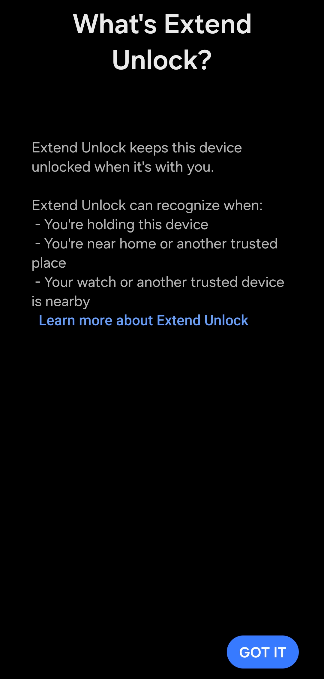

Do you have extended unlock enabled?
Great suggestions, thank you! I don't have extended lock on; however, I do have keep screen on while viewing. I just toggled that off to see if that helps and will report back.
UPDATE: After turning off the keep screen on while viewing, I am still having this issue randomly.
