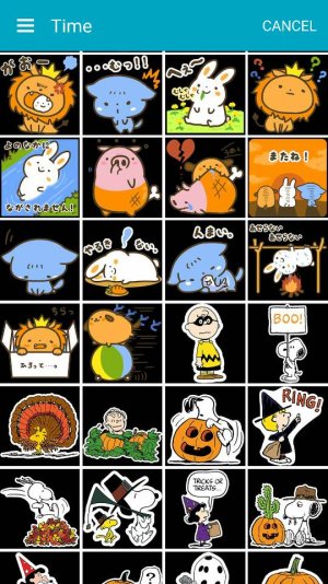

It shows like this in the pics when I open in the album but when I open in time it shows some my original pics and videos...yes sir I created .nomedia file in /DCIM/Camera/ in the directory ..

Sorry, but I'm not sure what to try next. In general, you shouldn't create a .nomedia file in a DCIM folder, since that's where camera photos are stored. If you created the .nomedia file, then deleted it, I don't understand why it keeps showing up again. Perhaps you should start from scratch with a new SD card, and this time, don't create .nomedia files in any directory with images you want to see in the Gallery app.
