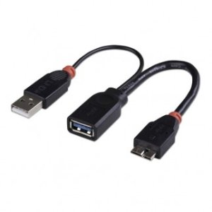

I have recently bought a "y" on the go cable - its a full micro USB 3 plug to go into the Note Pro (that is, a two-part plug, not just a micro usb 2 plug), then has two other usb plugs, one a usb 3 plug for OTG, and the other a full type A usb 2 for charging, but I haven't got around to finding out how the charger part works yet, as all my charger cables are micro-usb at one end, and I need a cable with male usb type A at one end and a female usb type A at the other end to use the charging connection. See picture:

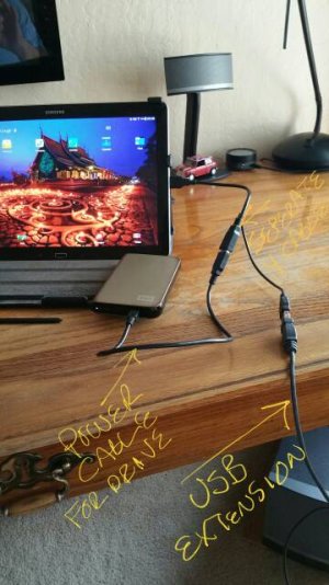

Madaudio that looks like the same cable I have. I've attached everything then unattached my external hard drive to see if the tablet would charge but it wouldn't. So the AC power comes in and goes straight to the hard drive. Of course if I disconnect AC power my tablet won't read the hard drive and does not charge. 20160301_095759-1.jpg

Madaudio that looks like the same cable I have. I've attached everything then unattached my external hard drive to see if the tablet would charge but it wouldn't. So the AC power comes in and goes straight to the hard drive. Of course if I disconnect AC power my tablet won't read the hard drive and does not charge. The Fatyank
Just for clarification, fatyank, the cable you have labelled "Power Cable for drive" is - to me - the OTG part of the y cable. That is, it's primary function is to allow the tablet to read the drive. Yes, while you have the other part of the y cable in (which to me is the power cable) it will also receive the charge from that other part of the y cable.
Interesting that your hard drive won't work without the power - my 1tb seagate works fine without power, but does put a drain on the tablet. Perhaps my drive has a lower power requirement. Your drive does look a little bulkier than mine.
The "Power Cable" as I call it is actually the cable that came with my external hard drive. It connects to a USB port on a laptop/desktop and draws power from there. I bought this drive about 5 years ago and it was the largest drive at the time (500gb). That explains the size. Largest SD card at the time was 64gb. The USB extension goes to the AC power block to power the external hard drive. The tablet will not recognize the hard drive without AC power. Old technology in the hard drive. I'm thinking of upgrading to a "modern" hard drive. If I connect a thumb drive where I have my hard drive connected, the tablet reads it fine without AC power.

Sorry, initially misread your picture - of course, the OTG is what's plugged into your tablet.
No problem. I label things funny. 22 years in the military so I still have my own language.
However, today I connected my external WD drive to my tablet to do some file backups. I was multitasking and had not connected to AC power. I take a look at my tablet and it is now powering and reading my drive without AC power connected. I don't know what happened or why it suddenly works without the AC power but I'm not complaining. Used it for about ½ hour or so with no problems. I even ran a few PowerPoint presentations from the external drive on the tablet. Worked great.
