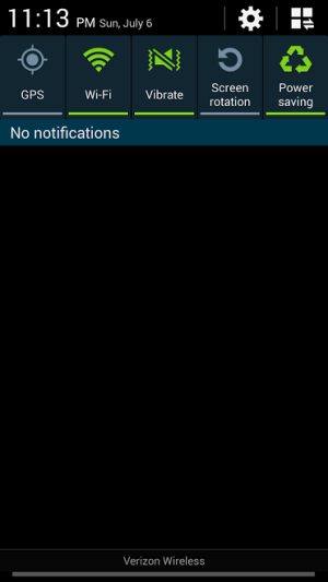

My notification bar looks like this:
My slider actually just came back. It's a weird and round-about fix, but I ran the app "Night Mode," which usually disables the slider and replaces it with a button that says "Night Mode." When I stopped the app, the slider re-appeared. Kind of freaky, but no reset required.
