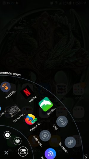

Any time I accidentally swipe at the lower corners of my screen, a new screen pops up. The top says "I'm feeling lucky" the rest of it has a spinning wheel anchored at the corner which shows 'recent apps'nor 'shortcuts' depending on what I spin to show.
How do I get rid of this? I don't know if it is a setting or an app but I hate it, hate that it keeps piping up when I am trying to do stuff.
I don't have ES installed. No ads, but this common apps thing is driving me nuts! I have the s7 edge so every time I tap the edge in a video-game this thing pops up, changes my orientation when it does, takes up time... pain in the rear!

On my Moto Z I had the same problem with the "I'm feeling lucky" when I swiped near a corner.
It was also caused by ES File explorer. There was nothing shown as ES Swipe in ES Explorer app to be turned off.
I was not able to shut it off from the ES File Explorer app, but instead used phone settings to successfully turn of the unwanted "feature":
Settings -> Apps -> ES File Explorer -> Advanced -> Draw over other apps -> selected and toggled off "Permit drawing over apps"
Bug is gone.
Thanks to people who posted before. I did a search and found the function was called "Lazy Swipe" on Cooling Master app...I turned it off and problem was solved.
Yes. I have the same issue.. I have uninstalled the ES file explorer. But it's still in my phone.. Thanks to imburns, that I checked a cooling app.. It was the Super toolbox app, the later versions didn't have this. Search in settings and there you will see the lazy app button.. Turn this off and. VIOLA! it's gone.
This annoyance showed up out of nowhere and it took a bit of investigation to find the culprit. I use an app called Call Blocker Free from NQ Mobile Security. This is called LazySwipe and it's a recent addition as I've been using this app for months. Not anymore!
