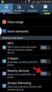

On an ATT Samsung Galaxy S3 running 4.3 Jelly Bean (not rooted), I want to create a shortcut to Nearby Devices so I can easily toggle on/off my DLNA. It is found in Settings | Connections | Connect and Share.

Hey sauce_a_poutine, thanks for the reply, but I just want to toggle my Nearby Devices on and off. When Shared Devices is on, my DLNA-enabled television recognizes media on my Galaxy S3, I don't even need to specify a folder. But I don't want to leave it running all the time. I did try using ES App Manager, which also has an 'Add to desktop' option when I navigate to Nearby Devices, but it didn't add it to my home screen (or any screen) for some reason. I may try the Tasker app if I don't get any answers.

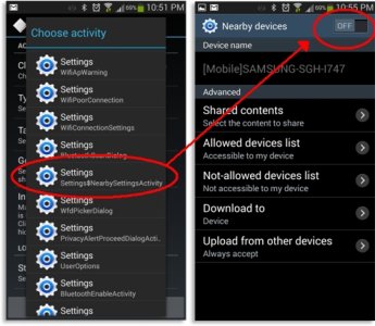

I gave up on Tasker. Was able to create a regular shortcut as an 'Activity' to Settings$NearbySettingsActivity, which gets me pretty close to the toggle.
