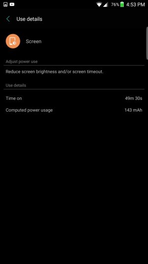

It would be helpful if you can share the battery graph, usage bars and provide a description of your usage pattern.
I always tell users to not only share SOT numbers, but also overall device uptime, battery graph and roughly how your usage pattern is like as it paints a better picture of how a battery should theoretically perform since we can add more factors.
SOT directly correlates to usage pattern. 12 hours of SOT might sound impressive, but if it's 12 hours from constantly watching a movie until it drains, that's not as impressive as 12 hours of SOT from normal use (though that depends on what you constitute as "normal use")
