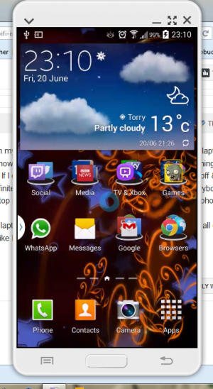

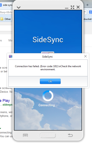

No, I see the request immediately on my phone. I start SideSync on the device & then on the laptop. It says on the laptop locating devices & the note shows up in the list underneath, however, the busy circle thing keeps rotating as if it is still looking for another device. If I double click the Note 3 entry, the phone screen goes off & the image I posted above appears. They are definitely on the same network as I can use the mouse & keyboard on the laptop if I choose that option from the desktop software drop down menu but it still wont display the phone screen.

I've got the identical problem as the OP with my Note 3 and Samsung laptop running Win 8.1. Turning off Windows Firewall didn't fix it for me but produced a different result -- instead of getting error code 101 as in the screenshot above, the PC app just keeps displaying "connecting" with the spinning wheel but never actually connects or times out. The Firewall was already configured to allow SideSync to bypass the firewall while on private networks, and if I leave it turned on I get the error code 101.
