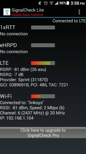

I use Signal Check, LTE Discovery, and the debug menu ##33284# But now it seems to stay steady when on WiFi. And the debug menu says I'm on band 26 but the others don't show it weird?
This is what I ment about band 25.

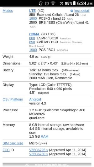

And correct me but Band 26 is 800 or 850 MHz? Band 25 1900 MHz, and Band 41 (Sprint Spark?) Is 2.5 MHz. And I only have b26 and b25 in my market right now? And which would give me the best speed based on the 2 bands active in my market?

This is how Sprint's tri-band LTE network is setup, the network decides where to put you at any given time. If traffic becomes a burden on any of the three bands the network will place you where you should have the best experience. Band 41 should be the most priority due to it being deployed on large 20MHz carriers so bandwidth and network congestion shouldn't be a factor if your connected to it unless the signal becomes degraded then you will be placed on either PCS or SMR.
