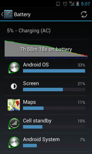

Hi everyone - I'm also having pretty poor battery life with JB, and I was wondering if someone could help me improve it by narrowing down the culprits. I'm currently getting about 8 hours of usage per charge, which is much better than my old Samsung Replenish (6 hours or less), but still no where near where I would like to be.
My issue is that "Android OS" and Maps combine for about 45% of my battery usage over that 8 hours, and I think that's a little much. Screen accounts for around 25%, but I use the phone a lot, so that can't be helped.

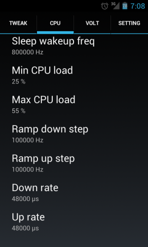

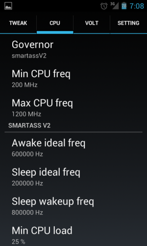

My ROM is Codename Android 3.6.5, and my kernel is Air Kernel release #224. My CPU/Governor settings are in the screen shots below, as well as a typical battery usage chart. The performance I'm getting from the phone is great, so I'd really like to keep it about the same, but I'm willing to sacrifice if it results in major improvement.

I freeze maps with titanium backup when not in use. Also the os usage might be solve by a clean install. I have never noticed that high of usage with it

I would do a clean install also. This always helps me when I see a high OS drain.

I seem to have gotten much better battery life after a wipe and reinstall. I think also turning off Battery Monitor (put an icon in the top bar to help me keep an easier eye on the battery - color and number) after installing a mod (I'm also rooted now, though still otherwise stock, so I don't think that's made any difference) hixanthus provided helped even more for me.
I did a clean wipe and reinstall (updated to CNA 3.6.6), but Android OS is still using 22% of my battery after 8 hours and 40 minutes on battery. I really hope that the additional OS drain isn't caused by CNA.
