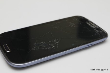

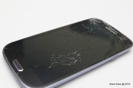

Ok, so I accidentally dropped my phone on a concrete walkway a couple of weeks ago and ended up with this:
I like to just go with an invisibleshield on my phone and no case. Unfortunately, it fell JUST on the right spot on the corner/side where the concrete hit the space where the invisibleshield wasn't - I'm not saying the invisibleshield would have prevented this, just that it definitely hit where it wasn't covering. Fortunately, having the shield on there was nice because I was still able to use the phone and none of the shards of glass dislodged, so that's nice.

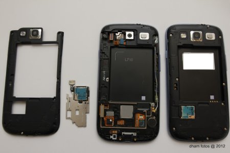

In any case, here's the new parts and the old next to each other (this is prior to me taking the cover over the motherboard off, the device on the right should look normal to you):

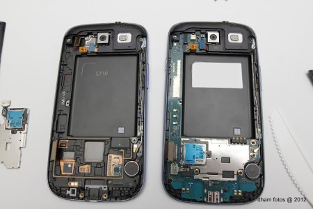

Here it is with the cover off, just several philips head screws which is VERY nice, thanks Samsung!

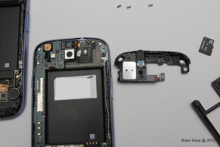

Here's the speaker portion popped off. It just comes right off with a little fanagling, no screws or anything which is nice. The bottom microphone piece comes out the same way.

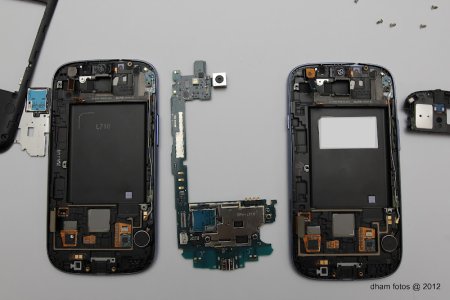

Here's the motherboard pulled out, it's only held in with one screw on the bottom portion and that top speaker piece that popped out:
And here we are all put back together, just exactly the opposite of how you take it apart, the whole process was probably 30-45 minutes tops because I was very careful and taking pictures.
