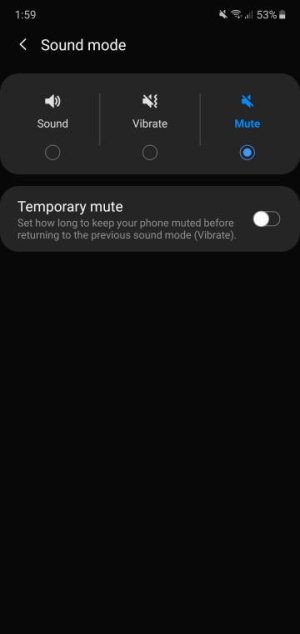

I think I might have found your issue
Long press the speaker in notifications panel see if temp silent is toggled on by accident Screenshot_20190827-015923_Settings.jpeg

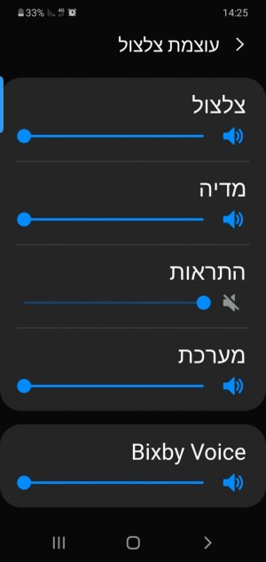

i tried it already . i tried everything . i put a screen shot . my phone is in Hebrew so the first slider is ring, the second slider is media , the third slider is notification , the fourth slider is system and the fifth slider is bixby . when i wake up in the morning and take out my phone from silent that is how it looks..Screenshot_20190826-142510_Settings.jpg
Thanks, that's a handy feature that I hadn't known about.
As to the OP's problem: I just tried muting and then unmuting my phone, and all sliders, including notifications, return to normal. Does your problem only occur after it's mute for a long time?
Also, are you sure your screenshot is showing the actual volume settings, rather than the settings to be used for muting? (The actual volume settings show up when you bring up the volume slider by using the volume keys, and then drag downward on the handle below the slider to expand and see all the other volume sliders.)
YES . it happens only if my phone is on silent mode for a long time (all night) my wife has the same note 10+ and the same problem
The screen shot i uploaded shows the way it present in the morning when i get out from silent . everything goes back to full volume except the third line which is the notification , stays on zero volume
