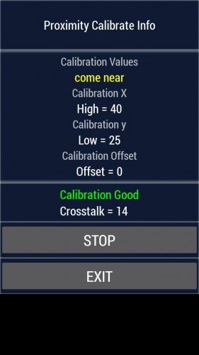

Open the DialPad on your Yureka
Dial *#*#7769#*#*
In the proximity calibration screen, tap on Start
Wait a few seconds till it reads Calibration Good (in green)
Tap Exit and you’re good to go.
