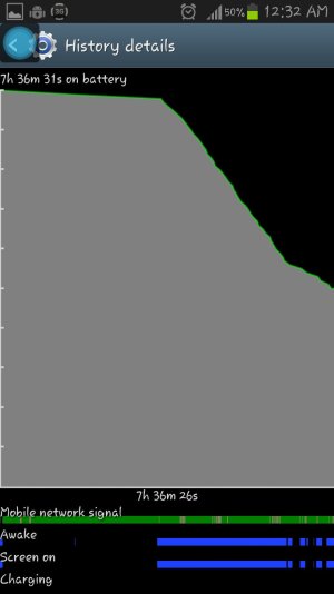

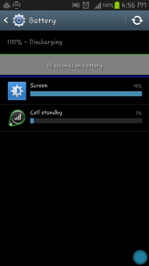

Here the screenies.
First screenshot is right after I charged for 14 hours straight. It was from a fully discharged phone.
Then, after about 5 hours of letting it sit for sometime with no activity, just 1 percent power loss.
Then, then from there I played townsmen, and did some tweeting with friends, power was down to 50%.
Like seriously. Less than 3 hours of abuse. Half of the life is gone. You think I need to do a factory reset?
