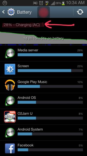

Where can I see if it's AC or USB? I go to settings, Battery and it just shows all of battery usage
Hello.
Yeah, you're on the right page.
Now, try to look at the top side of the screen.
Where in it shows you the battery life percentage. It will show "##% - Charging (☆☆)"
The ☆ represents the AC or USB.
I highlighted it for you in the screenie. :)
(You have to be charging to see it though.)
Sent from my GT-N7100 using Tapatalk 2

Hello. Based on your scenario that the red light wasn't on all the time. I guess it is either with the usb cable, charger, or socket. Any of the three could not be delivering electricity continiously. Try a diferrent socket, then a different usb cable, then a dirrent wall charger. Also make sure that the charging indicator ia at AC and not USB.
(Check screenie above.)
