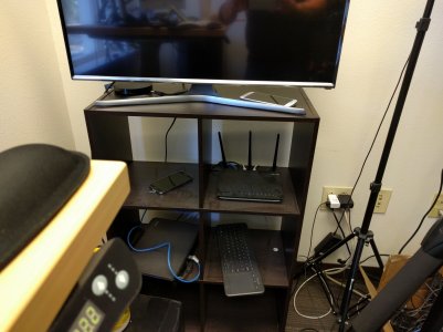

If you don't mine me asking, were you far from the router of somewhat close? Only seems to happen when it goes through a couple walls where as my Nexus 6P does not have that problem. Also I am only really 25-30 feet away from my router "as the crow flies".
Thank you again for your time and effort. I really appreciate it!
Exactly this far:
Exactly this far:
Yeah mine was fine up close like that but download speeds went drastically down hill when I was just 30 ft away and through a couple walls. My Nexus 6P did not have any issues at the same distance.
