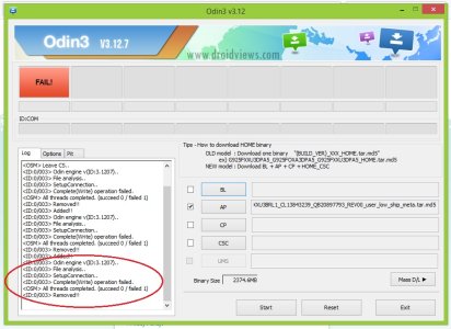

That doesn't work :
<ID:0/003> Odin engine v(ID:3.1207)..
<ID:0/003> File analysis..
<ID:0/003> SetupConnection..
<ID:0/003> Complete(Write) operation failed.
<OSM> All threads completed. (succeed 0 / failed 1)
<ID:0/003> Removed!!
I don't understand why
Thank you very much
Something went wrong. Usually when that happens, I leave the phone turned off for a while, then turn it on and try again. (Are you sure you downloaded the ROM for he FN version of the phone, for your country, for your carrier? An error there can cause the problem - you can't mix and match phone and ROM variants. So can a glitch in the connection (use a quality cable and a good computer). So can failed eMMC storage in the phone (which would require a new motherboard, so hope it isn't that). But the connection to the phone failed, that's the final result. The cause could be a few things (as I said above, and I may be forgetting a few) but the problem is that if you can't do it yourself, and have to have someone JTAG a ROM into it, it's going to cost as much as a newer phone with the same specs (that one is about 18 months old).
It's not a problem in what you're doing, though. I've flashed at least 100 phones with many different versions of Odin (back to 3.09), and unless the phone was shot, it just worked.

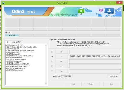

Hello,
thank you for your answer,
Yes I'm sure I've downloaded the good ROM for SM-J330FN, with my country and the operator
I tried an other time by open Odin as Administrator and with an other USB port
Now connection is good but the processus stop at "Boot.img" and stay like that long time
Thanks Rukbat for your help,
To inform people :
The probleme is solved, that can't work with Odin 3.12.7
The last version is required : Odin 3.13.1
