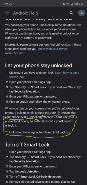

I finally got around to getting smart lock with trusted places working at home. I want to be able to tell google to turn on the TV and I am also getting some outlets so i can control my floor lamps.
i got up this morning and went to the living room and said ok google turn on the TV. My phone woke up and there was a notification that smart lock wouldn't work because I hadn't used my phone in 4 hours. It worked fine after i used my fingerprint to open it the first time.
Is there away to get out of this 4 hours of inactivity?
I'm thinking it may just be easier to get an echo dot or a google home mini. (both are 25 bucks right now)
Yup, that's how Smart Lock works. No way around it on the phone, unfortunately, other than using automation apps to keep your phone 'awake', say, every hour or two.
That's the reason? I really hate that every morning I have to reset my trusted place. It doesn't work again right after I unlock it, which I have to put in my code because the fingerprint reader is crap to unlock the phone, works great fortunately to open programs. Very fed up with smart lock.

How do you restart your trusted place? This has been an issue with Smart Lock for a couple years now....not working at all after a day or two. I'm at home all day and unless I have a Bluetooth connected, I'm having to unlock the phone every single time I go to use it-horribly annoying!!
I would love to 'restart' it each morning so it worked throughout my day.

Restarting the phone usually re-enables Smart Lock location for me.
