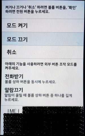

I get this now. Suddenly I boot into this. Tried translating services like Google no soap It's a .jpg & every time I convert it has Asian characters but it is not even close to the original. Anybody know what this means? The options are selectable so I have to know.

Just had a weird hopeful thing happen. Plug into data cable into pc, booted to LG screen. Then instead of the Korean? screen or the TWRP logo then home. It booted into the AT&T screen with the jingle then my Android home screen. After a few few seconds it powered down with a polite ~not enough power to turn on message.

But the 2nd to last time I turned it on with pwr & vol up at same time. Got the above Korean screen. Disgusted I turn off by a button combo I forget. Might have been all 3 or vol dwn & pwr. I set my LG G Flex aside for 12-24hrs. Then I plugged into data cable into pc, booted to LG screen. Then instead of the Korean? screen or the TWRP logo then home. It booted into the AT&T screen with the jingle then my Android home screen. After a few few seconds it powered down with a polite ~not enough power to turn on message.
