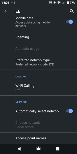

Does it have Esim options?
What if go settings >connection>mobile network>APN highlighted?

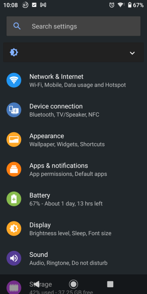

How exactly do I go about opening the sim reader though? doesn't seem to be any obvious way.

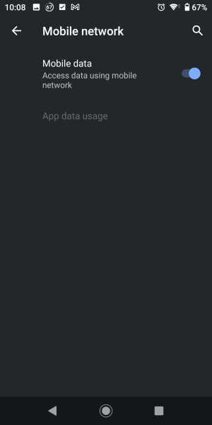

In the top search bar type network see if anything comes up?
Oh, I'd taken the sim back out...

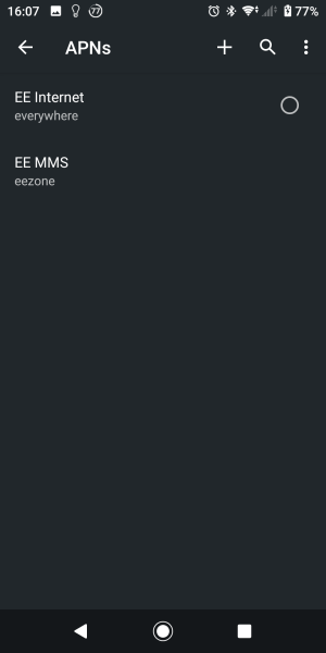

Now the Mobile network Menu looks like the first pic. It has an Access Point Names menu now (second pic), but nothing is selected.
It's the weirdest thing, under Sim Status it recognises that the sim is EE and the phone number, but no service.

Ok tap EE internet see what happens, it doesn't look highlighted
