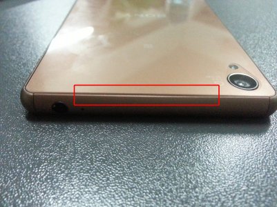

I bought the Z3 for about a week. Today i felt like that my finger slipped from the edge of the glass when touched the back cover. So i checked the back cover and found the top side and left side are above the midframe. I nearly believed it just should be. When i tried to press the edge of the back cover, i noticed it came down a little, and when i let go, it went up again. Though it's a tiny move, i really saw that very clearly. Why it happened? Overheat motherboard? Do you have the same problem? And if the phone still waterptoof?
That doesn't look right. You could test if it's waterproof. To check it you have to close all flaps and call *#*#7378423#*#*, then go to service test and pressure sensor. With all flaps closed press gently on the screen, if pressure will increase that means the Phone is probably still waterproof (although I can't guarantee).
