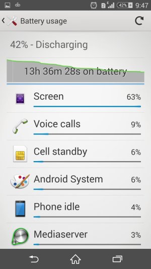

Got my Z3 last night. Amazing device. Took the AT&T rep about 30 minutes to get the new sim working with AT&T network, when I left the store I had LTE connection. I have terrible service at my house (edge/emergency only) - same thing happened with my GS3 before. Now the problem is it seems to be stuck on Edge. Either stuck on Edge or is no longer picking up LTE. Tried power cycling and cycling in and out of airplane mode. Still stuck! If I can't resolve it I'll be back to AT&T for a new sim, or switching to T-Mobile. Any advice?
In other news, the battery life on this thing is truly excellent. After heavy, heavy use throughout the day, I'm rocking 42% left here at 10 pm.

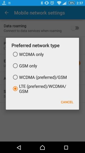

All I had to do was re-select LTE as preferred network in Mobile Network Settings -> Network Mode. Haven't had any issues since.

Yes make sure the APN settings are correct, but also make sure that the preferred network setting is LTE
