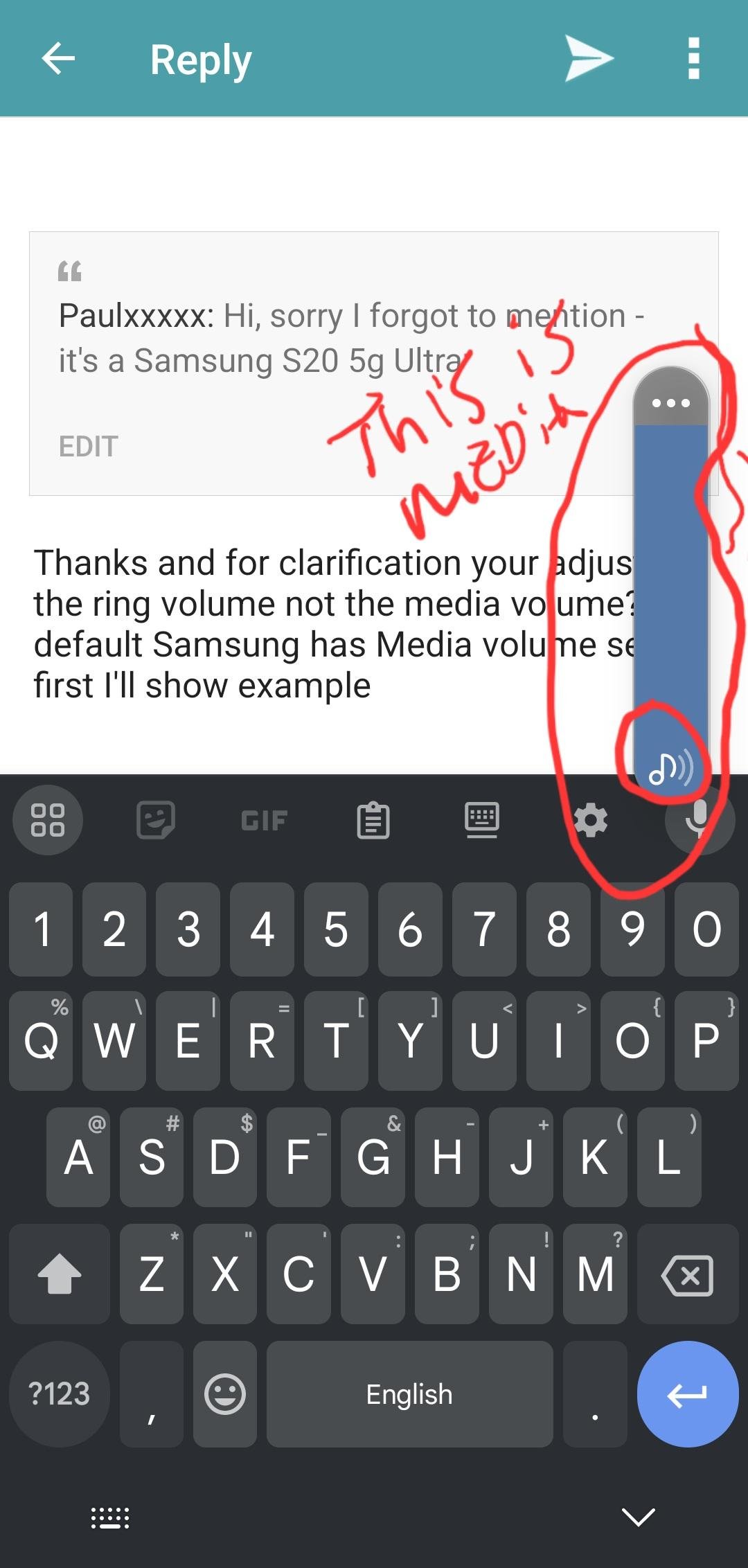

Thanks and for clarification your adjusting the ring volume not the media volume? By default Samsung has Media volume set first I'll show example
Make sure this is toggle off otherwise it may seem your adjusting the volume when u are only adjusting the media
