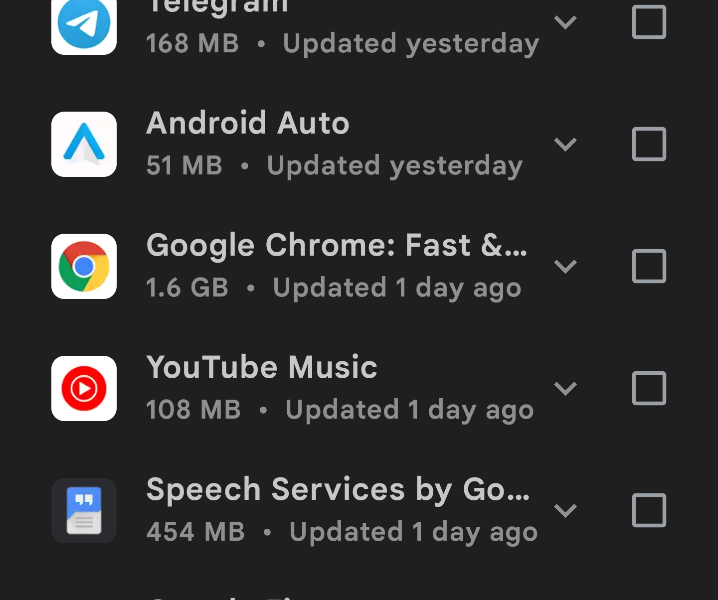

This thread. I dreamt last night that I received the update, and I was looking forward to see what happened. That’s all I remember. :(
(Whisper: Who’s going to tell B. Diddy that there isn’t no update, he was just dreaming.)
Actually there was an update. See screenshot.
