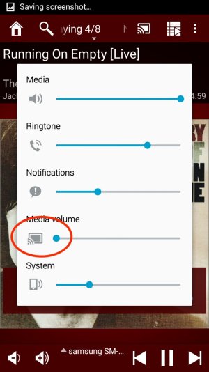

Hi,
When I cast to my CC, I get the song info up on my TV, and I can see new track info if I change tracks, and I can change the background. But I cannot see the cover art, and there is no sound.
See the enclosed screen capture from my Galaxy S5 running Android 5.0.
If I increase the media volume (circled in red), nothing happens. Next time I open the volume display, the media volume has dropped back to zero again.
I have no sound issues with any other apps through the CC.
Your Squeeze Ctrl plays nicely on all my other playback devices (Logitech players, PC's, phones, tablets etc.)
My library is a QNAP NAS running LMS 7.8
looking forward to a solution...
rgds
Viking

Re: Chromecast is deaf and mute....
Hi,
rgds
Viking
Squeeze Ctrl is a remote control app, not a player. Chromecast support is for display only, no audio. This was clearly stated in the app description.
Oops, sorry for my misunderstanding....
Anyway, I tried rebooting the Chromecast - and I did wait a loooong time (30min), but nothing happens.
All my MP3 files have the cover art embedded in the file header. I never store cover art as independent image files in the directory structure on the NAS. There are no cover art files anywhere on the NAS.

I meant playing internet radio, Pandora, Spotify, etc. But I know what the problem is now, I forgot to add the username and password to the image requests from Chromecast. I'll fix it in the next update.
Excellent :-) I'm glad that my incident revealed a fixable little bug.
