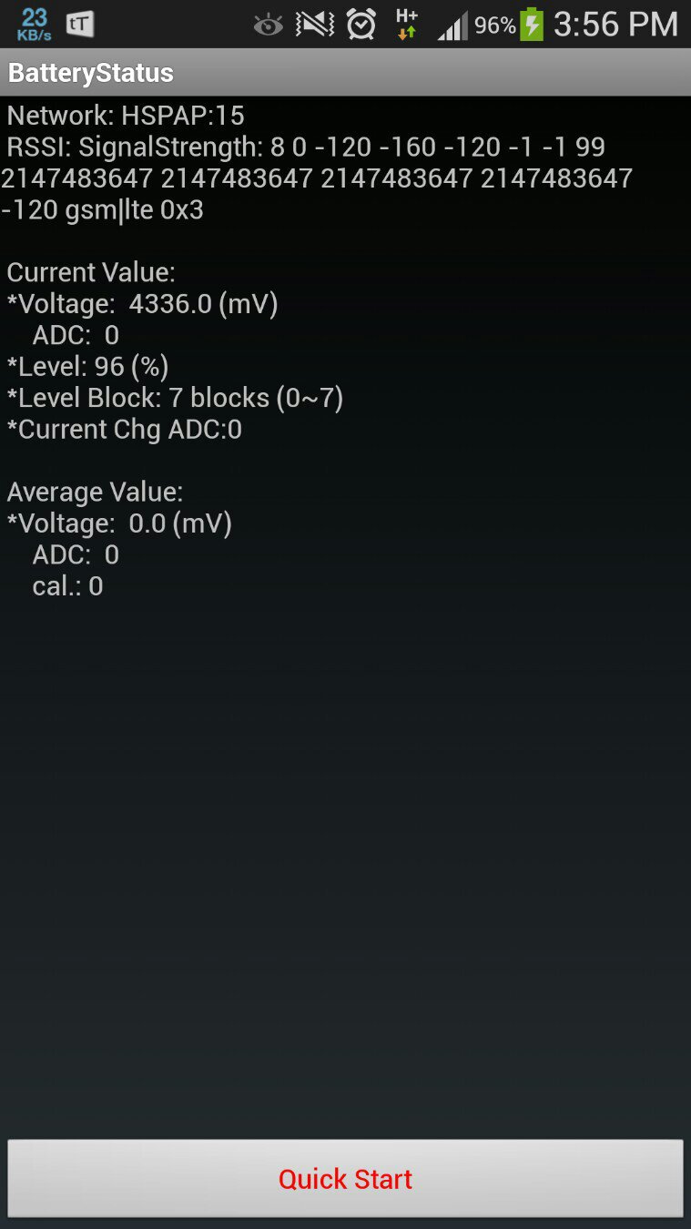

Go to your phone dialer and input *#0228#. It should launch this:
Hit Quick Start. It should recalibrate your battery and show you your real battery level. If it shows a value you don't expect, that is the real charge on the battery and not what you thought it had. Charge your battery to 100% again.
If this doesn't work, you have a bad battery. Claim your warranty from Samsung. Not the store... Samsung Service Center should do it as long as you have proof of purchase and warranty statement.
If not, buy a new Samsung original battery. Don't skimp out and buy one of those cheap knock offs as there have been reports of phones all across brands exploding or causing other injuries because they used non-official third party batteries.
