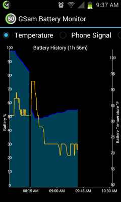

However, if I pull out the battery and let it sit for a minute or two, then put it back in and restart, I've got battery power back again, at a slightly
reduced level. I happened to catch it in action this morning with a screen capture a little after 8am where you can see after the reboot, it reported
having about 55-56% before rapidly plunging down to 48-49% power remaining. Then the battery percentage began to grow over the next hour
rising up to about 56% by 9:30am before starting a very slow drain. It's now noon and I'm still got 50% remaining according to the meter.

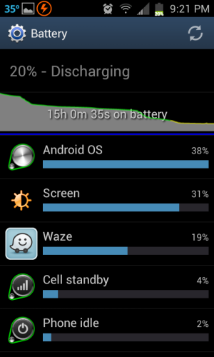

In case anyone's curious what the 3800 mA battery can allow throughout the normal work day. Its simply liberating.

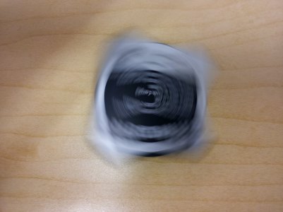

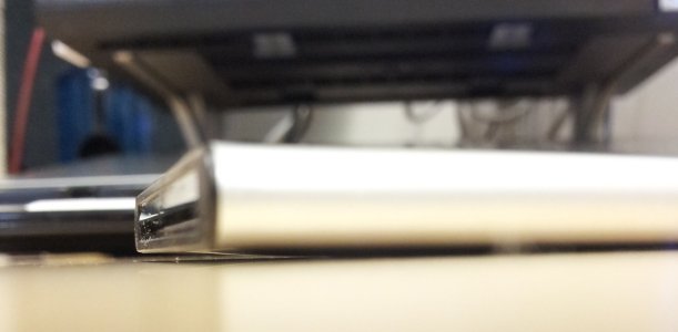

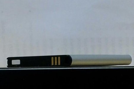

Wow, I've found a surprising development. After reading JayWill72's suggestion and reading about swelling batteries, I took a closer look at mine and low and behold, not only did my battery spin on my desk, but it was visibly swollen, as discussed in THIS thread. I'm thinking now that as the battery gets put into high demand and begins warming up, the swelling disconnects it from the prongs and that's why we're getting the blackout crashes. I may try replacing the battery to see how well my phone performs on an brand new stock battery.
Any suggestions as to where to buy an authentic SAMSUNG battery?
Anyway, here are a few pictures of my battery - one while its spinning, one showing the actual bulge and two showing the corners of the battery not touching the desk surface.
