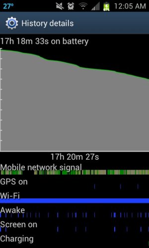

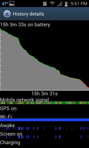

Just got the $15 genuine Samsung replacement battery and I was very disappointed with its performance. Here are three screenshots comparing the replacement 1800mAh battery (first screenshot) to the 3800mAh battery (second and third screenshot - both high intensity use and practically idle all day)
I'm sticking with the higher performance/capacity battery until my next phone...
