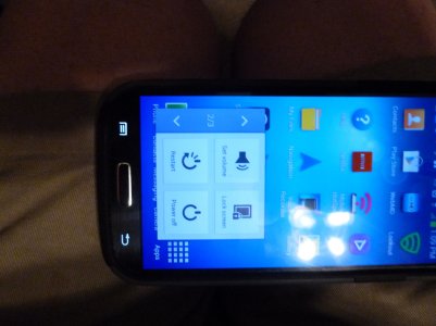

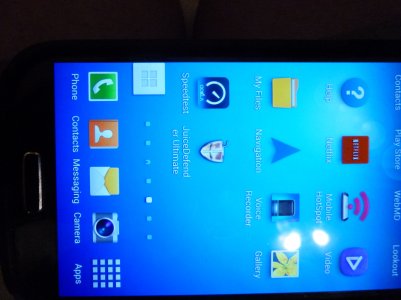

It is the white square above the Green Phone icon (Has 4 small squares within it).

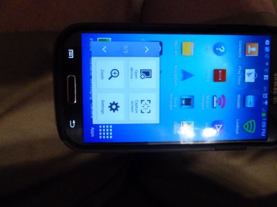

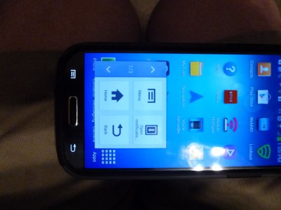

Also, here are shots of the menu when you tap on this icon

Go to settings>my device>accessibility>turn off assistant menu under mobility.

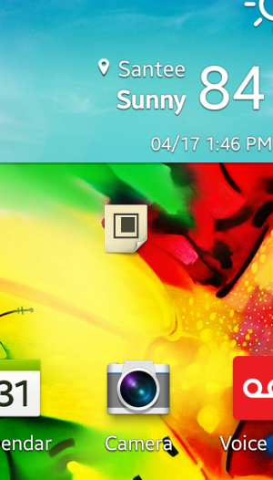

In the past 3 days or so I have this strange little square floating on my screen. If I try to tap it or hold it it will disappear only to reappear at a later time. Any clues? I haven't downloaded any new apps or reconfigured anything recently. Screenshots_2015-04-17-14-38-43.png.

On the note 3 it is in
Setup
Accessories
Dexterity and Interaction
Just turn that off and the box goes away.
