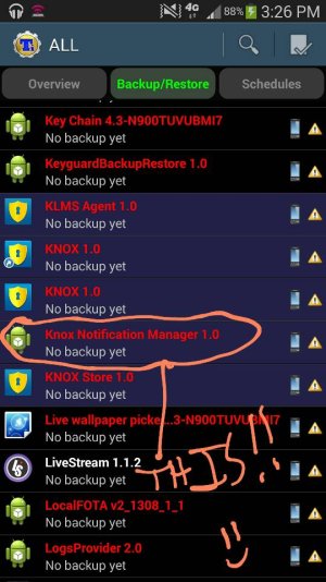

Guys I'm telling you this is Knox. It randomly turned on for me.. Without me doing anything... It tried to block my superuser (rooted) access.
If you pull down your notification bar and hold down on the notification a button pops up and you can hit app info. This works for ALL notifications in Android. It will show you what's causing that notification... And know what it is? I highlighted it below in the screenshot... It's called "Knox Notification Manager".
I froze all of Knox using Titanium Backup (rooted app) so it can't run and now I don't get that message anymore.
